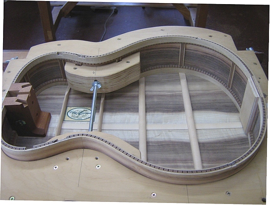

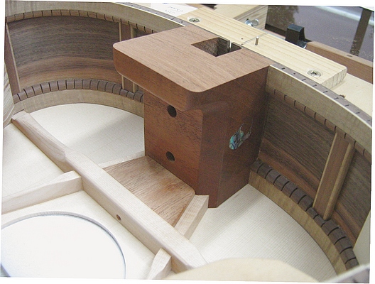

It will be a total bolt on. The Kiwi inlay in Paua is just a bit of fun , and should be viewable through the soundport
I installed the C.Fox style two piece liners , which are made from walnut and Tasmanian Sassafras caps.

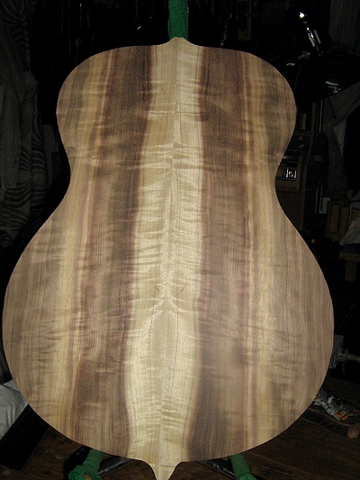

The Myrtle back with nothing on it. Should really pop later on. The top is Englemann.

That's super neat work there. Those linings look cool with the two different woods. Two tone side braces as well.

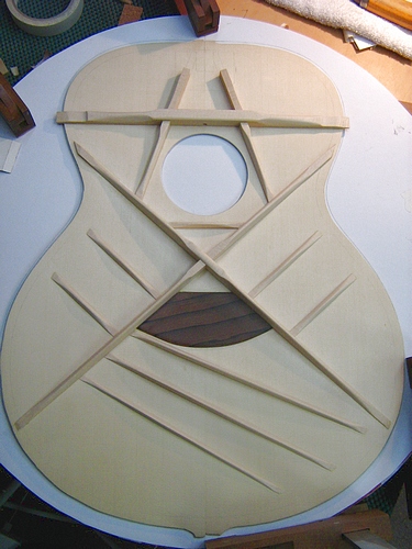

Are the 3 tone bars because it's a 12 string or just what you felt was needed to voice that particular top?
That myrtle looks stunning. With something like Z-Poxy and suitable finish it will really shimmer.

Thanks Dave. Yeh , the side braces are Walnut and Tas Sassafras as well. I figure a soundport is also a peep hole ,so I tryed to make the inside visually interesting.
I debated with myself on using a third tone bar , but because it's a 16 " lower bout twelve string , and after checking Taylor's ,I decided to go for it. Ended up with very small dimensions though at about 5 X 6 m.m.
I'll once again finish with U-Beaut hardened shellac .
The Myrtle was a dream to bend . The sides are 2.5mm (.1") thick. I'm trying for a lively top ,anchored at it's perimeter by very solid sides , so as to loose as little energy from the top as possible.

Who supplied your myrtle? I love the look of the blonde mid-section.

Very nice work indeed. I see you have followed through with the braces from the sound hole to the neck block. Is this another way to counter any chance of the sound hole area imploding? Good to see the robust bracing on the back lower bout area. I look ofrward to seeing the finished article.

The body is a sort of Grand Auditorium of my own design, which I find comfortable , yet still have a 16" lower bout .
The Myrtle was supplied by L.M.I. ( many many thanks you guys ). I asked them for the best they had ,as at the time, it was going to be used as my first build .They certainly looked after me ! I love the stuff ! No pores to fill either
My first has a Lowden type A Frame too Tim . I wanted a total bolt on as well as the A Frame and came up with this design , which I'm very happy with. Makes the headblock area plenty strong . The A frame braces are 1/2 " tall , so I notched them, and the transverse to receive them .

Craig that looks superb, great design and execution, The laayout and brace shape should give you the support and response your looking for in a 12.

Hey Craig, your lookin good here. Very nice design and the execution is superb. Your bracing seems nice and light and she should sound sweet.

Yes John , I have the braces as light as I dare. Your reassuring words are welcome thanks Colin . I do consider the longevity of instruments ,and so it is a fine line to get the balance right.
This one has a rather deep body to hopefully balance out the twelve string 'jangle '. I have also reduced the soundhole area to lower the internal frequency.
It's a 13 fretter with a 24.9 " scale , which puts the bridge a bit further into the lower bout and decreases the leverage on the neck , as well as aid the weight distribution.

Craig the more I look at that the more I like it!, I think it should be awesome, with a very pure sound with the attack that you need from a 12, they can sound awefully muddy those braces are sweet. Did I say I like it?
